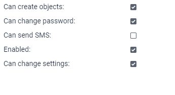

Hello zant, Your response was helpful. I understand the concepts. Just want to confirm the following: In my application, every user created already have the following : "Can change password, Enabled, Can change settings" and each those users have not enabled, "Can create objects" and "Can send SMS" (Screenshot 1). I want to enable "Can create objects" for every user. In this case, I have set flags = 4 since "Can create objects" is the only one to be enabled. For this, I have set flagsMask=0 since I am not changing anything else. When I tried it was working fine(Screenshot 2). Could you please confirm whether this approach is correct?  Just want to confirm another scenario as well. I am not sure whether users created in CMS always have   "Can change password, Enabled, Can change settings" - options enabled as I mentioned my case earlier. Using these flag and mask values (flag =4, mask =0), will the option "Can create objects" get enabled in other those scenarios as well? Could you please help me with this?

jisnajoby03 hello, in general, your variant is correct, but usually, to set specific flag it should be specified in both parameters, e.g. "flags":4,"flagsMask":4
As for the initial properties. Yes, the indicated flags are default.
When the new unit is creating in Wialon via interface the system executes several requests for creation and then to set flags and other requests. You can check the steps from your side in browser development tool (Network tab) to see all the steps during the creation of new user.
