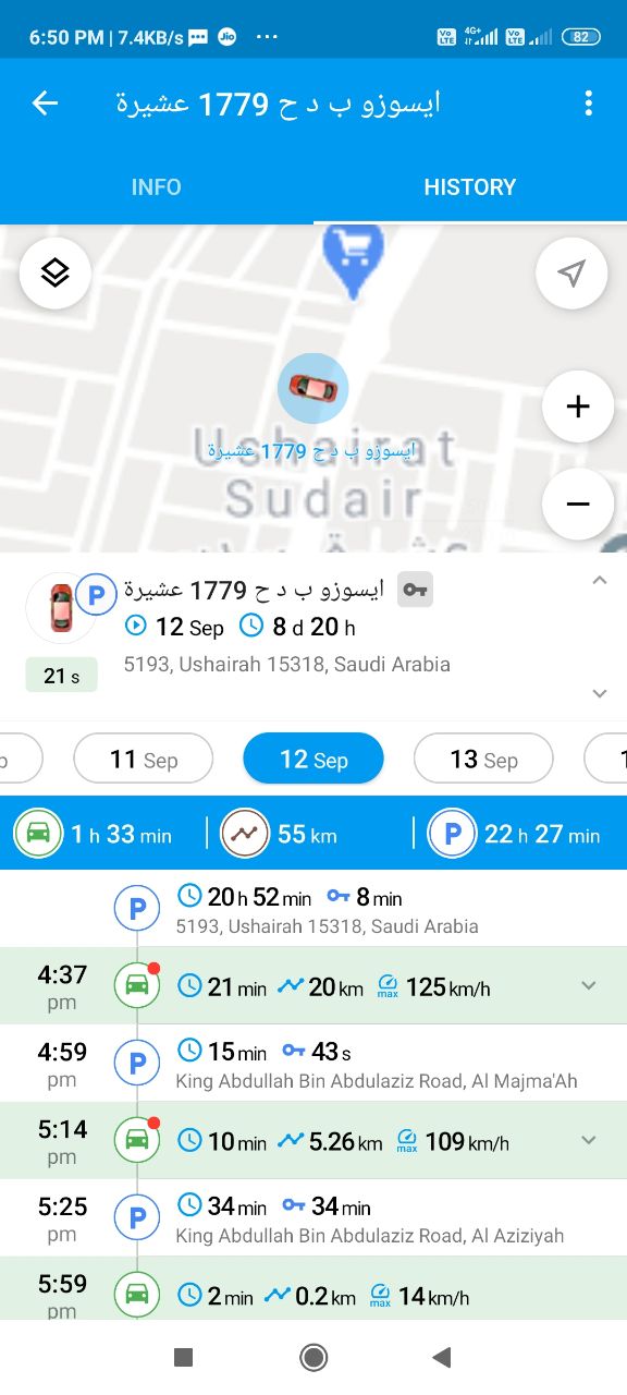

One more help if you can please do,
how I can get for info about units
1. Info of the unites with its status and location
2. History of the unit as per date more details. for e.g, i have attached a screenshot
thanks for your time
