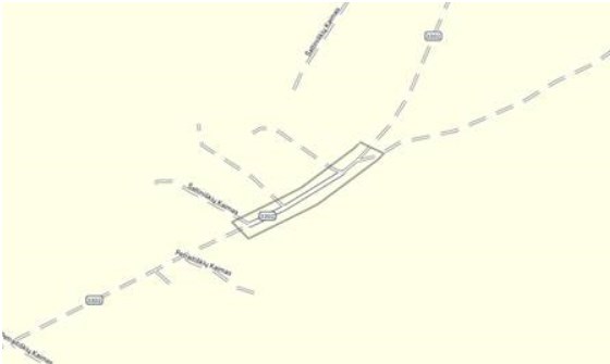

One of our client tries to create geozones using SDK. Anyway there is some kind a problem because after import geozone looks different then it should look (tested on google earth and manual geozone import). What does client doing wrong?
We are making steps like info bellow:
- Using KML file (attached bellow);
- We read coordinates from tag <coordinates>;
- then we are using service https://sdk.online.stavtrack.kz/wiki/en/sidebar/ … pdate_zone to create new geozone with coordinates from KML file.
- We present request with these parameters id = 0, callMode = create, n,d, t = 2, f =112, w = 300, c = 2566940364, p – coordinates (where r = 300);
Attached examples and KML.

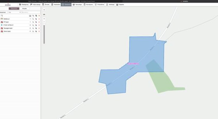

As we have analyzed x coordinates the same but y coordinates different. How could it happen as i do not see difference in KML file?
Also attaching picture with different results. Our result in yellow color. The difference are huge.
