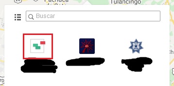

Hi, I have the development of an App in Node integrated into Telematics, but I cannot customize the icon by adding the "app" folder with the "logo.png". I send an image of what I would like to do, I hope you can help me. Thank you.

Hi, I followed the steps but isn't worked, my url looks like this: "http://notify/login/signin" according to my configuration in Node and I save the folder in the root of my project. I share a screenshot. I hope you can support me. Thank you
Hello Moniica!
You need to safe logo not in root folder, but at folder with name 'app'
When you add your app at Wialon by some URL, like http(s)://fulL_url_to_your_app.com/something_else/else, Wialon will try to upload logo from ULR
http(s)://fulL_url_to_your_app.com/something_else/else + app + logo.png =  http(s)://fulL_url_to_your_app.com/something_else/else/app/logo.png
