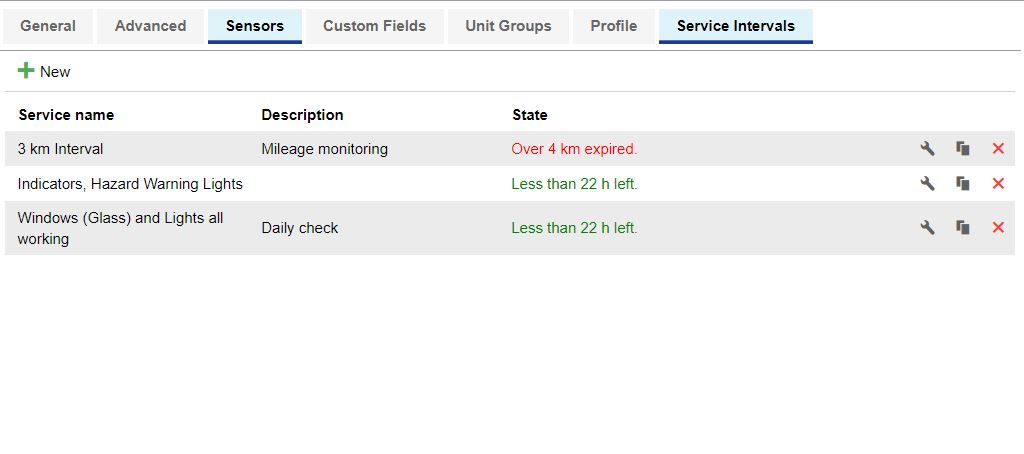

Hello everyone, I'm using JavaScript API.
I'm having problems to get the list of Service Intervals of a Unit. The thing is that I'm not sure if this is even possible using JS API, since the documentation about this is not provided.
I have tried to add the flag:
var flags = wialon.item.Item.dataFlag.base | wialon.item.Unit.dataFlag.maintenance;
But it doesn't help, i think is didn't exist. Do you know how I can get that list of Service Intervals?
I really really depreciate your help!!!
UPDATE:
There has been a while and I dont get answers. Please tell me if my question is not clear enogh? Or maybe it is just not possible?
Im also attaching an image that can help
  • Get the list of Service Intervals of a Unit.

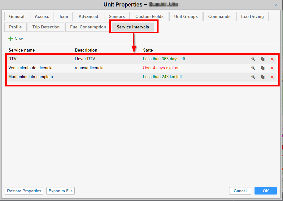

thanks for your answer. Even though I use the code as you send it ... the response in console continues to be null, I do not know what I'm doing wrong
I attach my code to see if you can help me
Опубликовать вложения
Иконка вложений intervalos.txt 2.58 Кб, файл был скачан 498 раз(а)
Re: Get the list of Service Intervals of a Unit.
I do not understand why this program gives me a response null. I already verified all the json and only that section is in null, what can I do to repair this?
