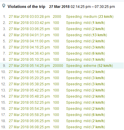

Is there a way that speeding can be filtered in order to disregard, similar to Message validity filtration in Advanced settings of unit?
I see a number of Speeding violations that appear to be way off the charts, suspect that either it may be the unit or another issue. As shown in image attached - one shows the truck driver was doing 54km over speed limit. Maybe we can adjust Eco Driving settings to ignore what would be in this case incorrect?
We have found using limits from roads often very inaccurate sadly - speed changes with roadworks are common and take some time to update.
Cheers.
"Messages Validity Filtration" helps to filter out the GPS data from invalid message. If speed from message exceeds value from tab "Advanced Properties", than speed, coordinates, satellites count and altitude are deleted from the message. It means, that it can't be used for speeding or Eco Driving control.
I see a number of Speeding violations that appear to be way off the charts, suspect that either it may be the unit or another issue. Maybe we can adjust Eco Driving settings to ignore what would be in this case incorrect?
Also you can use "max speed" filter in Eco Driving criterias to cut off high speed values.
Roadworks start and finish everyday, it is almost impossible to keep road limits up-to-date in the whole world in real time.
Still you can apply changes in OSM -- our map specialists periodically take new data from this source.
