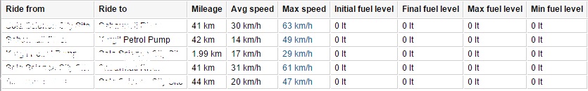

Hello,
I used analog fuel level sensor and its readings are completely observed in unit tool tip. It is oaky. Client want report of fuel level in geofences. At every geofences he want fuel level report. i made a ride report and select initial fuel level, final fuel level but it showing 0.00 litre. What is the problem ? Where I do mistake ?

is Enabled Fuel control in fuel tab?

Hello!
You need to enable option Fuel Level Sensors  at unit's properties on Tab Fuel Consumption
