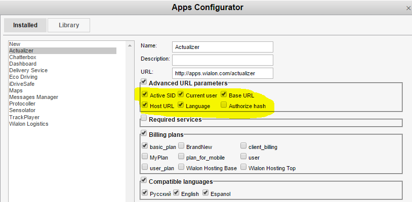

Hi Spev
Thanks for the reply. Can you share in which area of the app configurator i should add my custom parameters. I have attached the app configurator screen shot.
Thanks

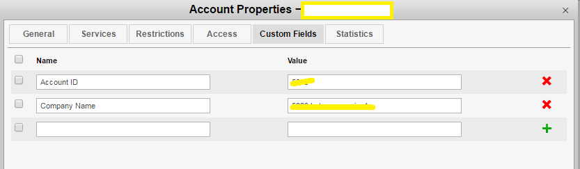

Hi
In Javascript API how to get the Custom fields of an Account using logged in users object.
I have attached the screenshot of the account custom fields
Thanks

Re: How to upload an app into account Gurtam?
prabhu.janakiraman, to get user's account custom fields use such request:
var accountId = wialon.core.Session.getInstance().getCurrUser().getAccountId();
wialon.core.Session.getInstance().searchItems({itemsType:"avl_resource",propName:"sys_id",propValueMask:accountId,sortType:""}, 1, 137, 0, 0, function(code, data) {
console.log(data);
137 - flags:
0x00000001 - base flag
0x00000008 - custom fields
0x00000080 - administrative fields
Head of Wialon Local Department
Gurtam
prabhu.janakiraman, as for additional custom parameters - You can pass them to app.
Just set app URL in CMS Manager with Your parameters, for example:
http://my-dns.com/myapp.html?test=123&param2=ok
